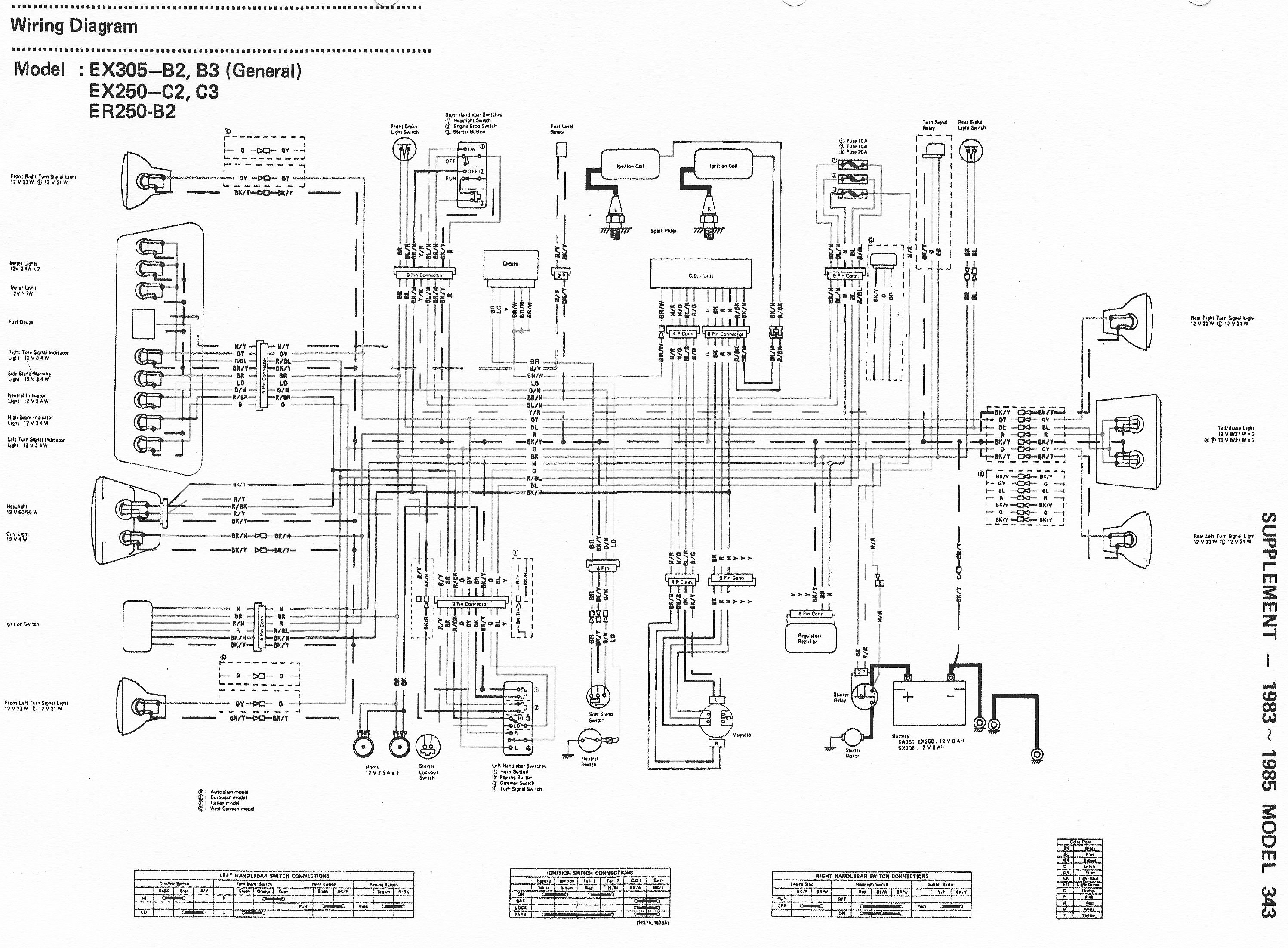

were is the impuls coil located on the bike (wire colour) also the loading coils.
hope fully going to try checking them tomorrow night wb |

Lothi Site Admin
Anmeldungsdatum: 29.06.2003 Beiträge: 609 Wohnort: Nürnberg
Nach oben |
