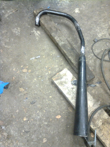

I didn't plan so, but I ended up cutting into 4 parts:
Finished product without paint:
Muffler seemed to be OK, but I'll check it:
My plan is to cut muffler off and then turn on the engine (around 3500 rpm the rattle occurred). If rattle remains, then the problem is in the header.

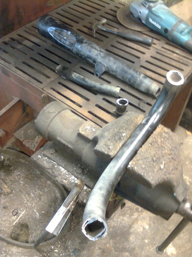

In the beginning (pics are clickable):
A crack inside the exhaust (near the cylinder):
Tried to weld it from the existing hole in the middle of the exhaust (it was a bit messy):
Then I decided to make a small cut which I welded later (I only cut the outer layer):
But it turned out that the rattle remained. It seemed that the rattle came from the muffler. So I cut open just below the muffler and I found that the inner muffler tube (perforated) was connected with the outer layer only at the end of the muffler. A red arrow shows the gap:
So I welded the layers together:
This turned out to solve the problem.
