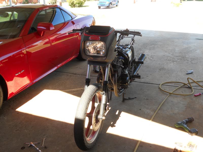

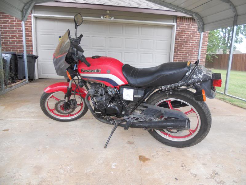

I just got it about 2 weeks ago. The previous owner said it has been sitting outside but only has 8000 miles on it. I'm planning on a full restoration. I want it to look like it is brand new again so it will be my winter project. I will keep updating this post as a build thread. I build classic and antique cars so it will be done with lots of detail and respect. My father bought me the exact bike when I was 15. Now I'm 41 and wanting a time machine. I had a want ad on the internet for about a month when this guy called me. Here's some before pictures.

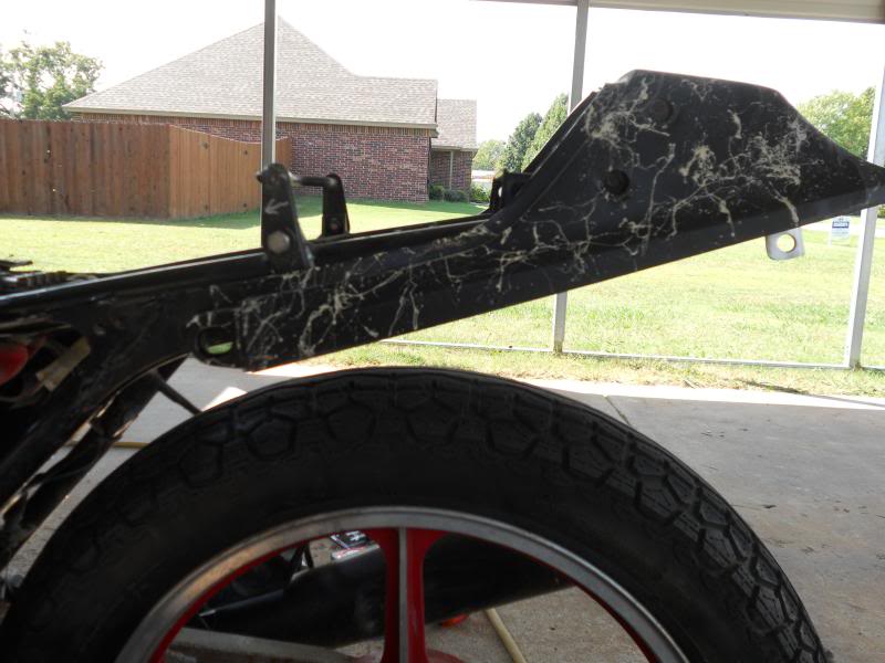

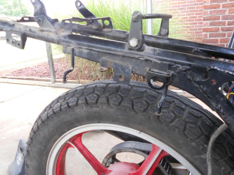

I'm having a tough time deciding if I want to lightly customize it. I would like to lower it about two inches front and back and may put on some smaller stock looking blinkers. I would also like to relocate the horns by hiding them in the front fairing or under gas tank. I could cut off the mounts on the frame and smooth the tubes. That would clean up that area alot. I also do not like the bungy cord tabs that are welded on the rear frame rails. I'm afraid if I customize it too much, it will not be the time machine I am looking for. What do you guys think?

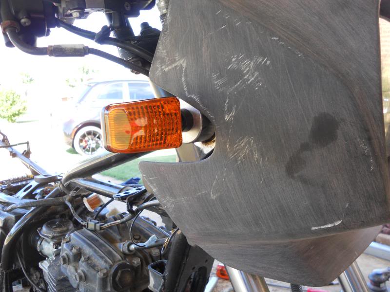

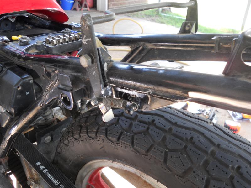

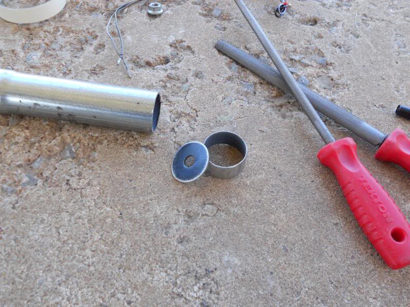

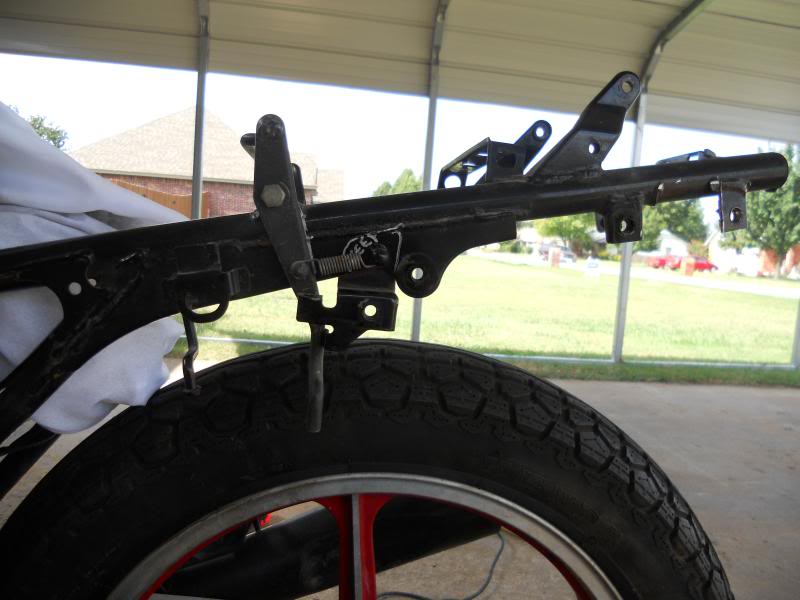

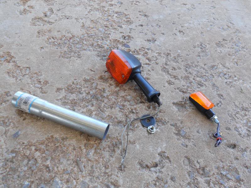

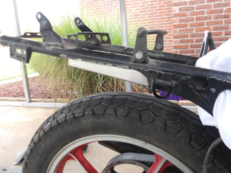

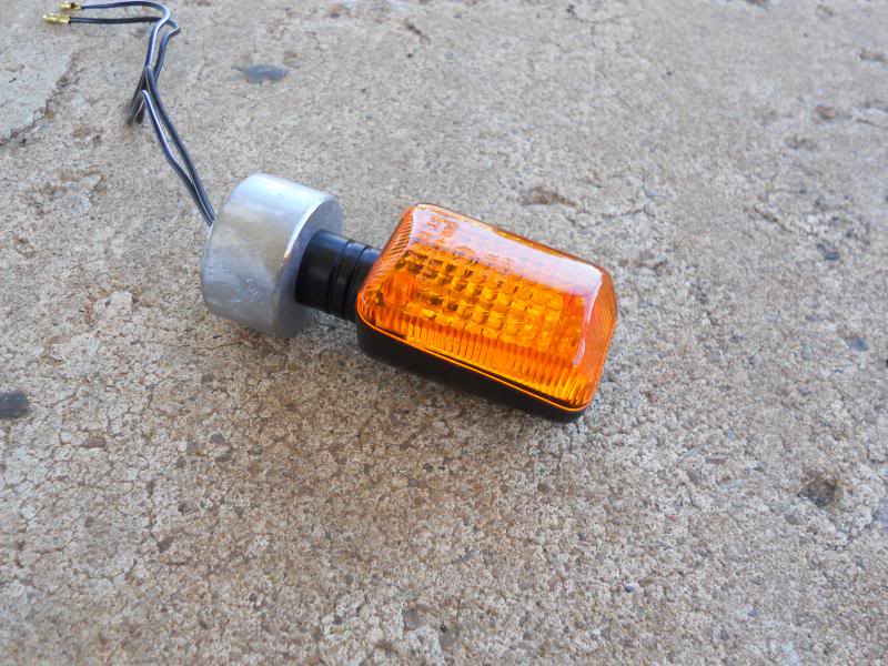

There are a few subtle changes I'm going to make to clean it up like removing unneeded stuff off the chassis. All the brackets for rear grab bar, helmet locks and bungy cord stubs went away today. I modified the lever for seat removal by shortening it, welding on a pad for my finger, and welding a stopper on the frame rail. I bought some small blinkers that look like the originals. The stock ones are bulky looking. My decals (stock) are supposed to be done friday. I had the original decals copied and made with a digital printer so they are not stacked seperates. I had a pint of base coat candy red, pint of starburst silver, and a pint of med blue effect mixed at my auto paint store. I'm going to paint on the stripes, put on all the decals, and clear all the body parts. I'll then sand and buff to mirror finish. Found a car stereo amplifier wiring kit at Walmart on the clearance rack. It's the same gauge as my GPZs starter wire. The wire shield is red but transparent so you can see the wires inside it. Thought it would be pretty cool to use it for a new starter wire. My rubber boot protecting the hot post on the starter is badly dry and cracked. I ordered a new one today from my local Kawasaki dealer. The kit also included a transparent black for ground. I'll use it on my engine to frame ground.

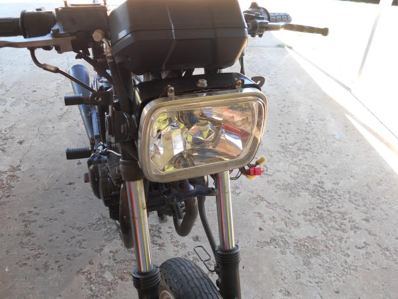

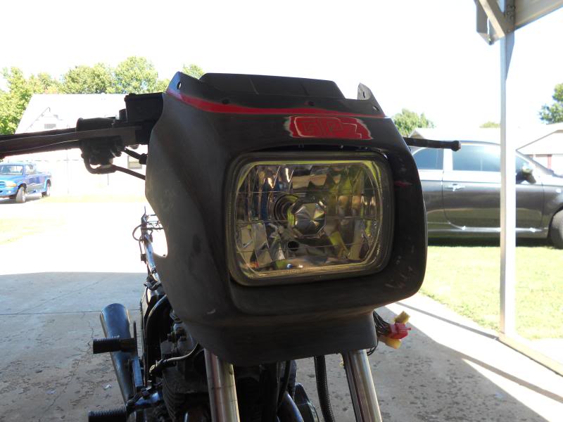

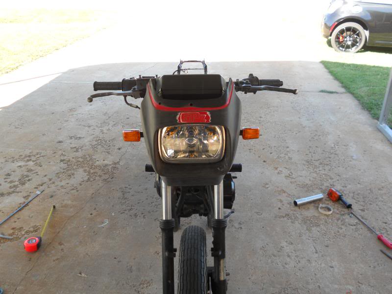

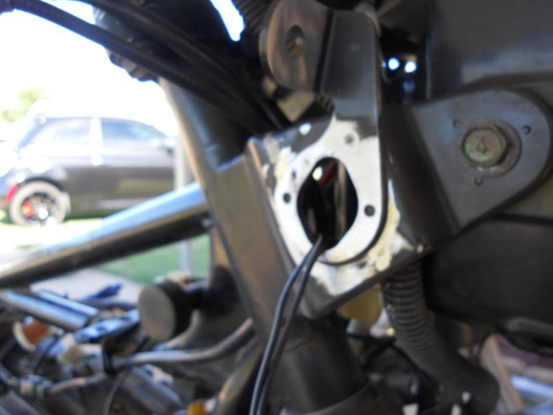

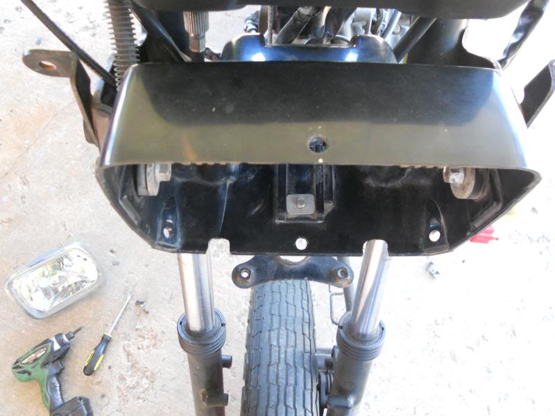

Picked up my decals today, he made me an extra for the master cylinder lid just in case of brake fluid spill or whatever. I also have a pair of headlights that I'll never use on a car so I decided to try to fab one onto the bike. I went to a salvage yard and got the ring and bucket from a Chevy S-10. I seen a 2001 ZRX1200R with this style light and thought it made it look more modern. I actually found the motorcycle headlamp like mine on ebay but the side adjustment screw is on the wrong side and its in Taiwan. So, I spent $5 on a bucket/ring and fabbing is free. I'll build an adjustable setup so it can be aimed wherever. I went back to Fastenall to get my #80 drill bits and they never got ordered. They had the stainless socket caps for my engine sidecover that were really long. I had 4 different lengths I was not being able to locate. They had to order them also but they did sell me just singles instead of having to buy bulk. I'm repainting the engine black but wanted to use stainless socket caps that I'll polish to give the engine a little detail.
Hafrod
Anmeldungsdatum: 28.09.2013
Beiträge: 34
BeitragVerfasst am: Mi Okt 09, 2013 10:55 pm    Titel: Antworten mit Zitat

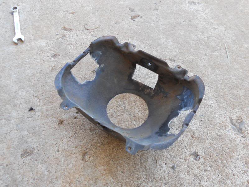

Got a good half day in on some fab work. I decided to mate the S-10 headlight bucket into the GPZs headlight bucket. This pulled the headlight out of the fairing about 3/8" which I like better. I altered the GPZ bucket very little and it could be put back stock if needed. The S-10 bucket took alot of cutting and trimming to get the fit. I have not designed a side to side adjustment yet. I'm going to ride it around the block tonight in the dark to see about where the beam is on the road. I shined it on my garage door and it appears straight. I may not use a side to side adjuster. The front smaller stock look blinkers were a bit of a problem when I went to mount them. I had to build 3/4 long spacers out of 1 1/2" muffler pipe. I used the original blinkers large washer on the ends. Welded them up and ground them smooth. It almost looks like a stock piece. I'll have to fully weld the spacers to the blinker mounts. I'll grind them smooth with a bevel and use body filler for a nice finished look after I remove them from the forks. This way they will appear as one piece.

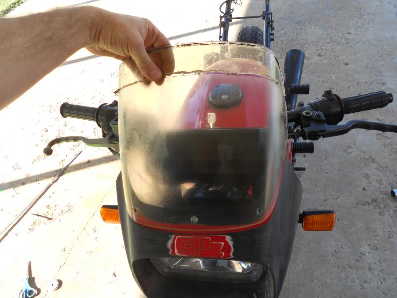

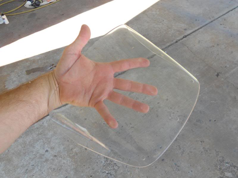

I had found a plastics company that would reform me a new windscreen for around $100. It was going to be moulded off the original which would make it a bit bigger. I thought I would build one out of sheetmetal formed from under the windscreen so it would fit properly. I started messing with my severly scratched and milky original. I decided it was too tall. I cut it down two inches and reshaped the curved corners. I like it waaaay better with a chopped windscreen. I grabbed my DA sander and the only fine grit DA paper I had was 1200. I sanded it pretty hard for about 5 minutes. Almost all the scratches came out. I buffed it just with compound to see if it would try to shine and it did. I thought it was cracked but it was a scratch. I'll go to the paint store tomorrow and load up on some 1000, 1200, 1500, 2000, and 2500 grit DA pads. I got more time than money so I'll try to salvage it.

BeitragVerfasst am: Do Okt 10, 2013 6:55 pm    Titel: Antworten mit Zitat
After sanding and polishing for about 2 hours, it turned out pretty nice. I will not be replacing something that turned out this good. I DA sanded it with 1000, 1200, 1500, 2000, 2500, 3000, and 4000. I spent about $30 in materials but already had the mini air buffer, buffing compound, and plastic polish.

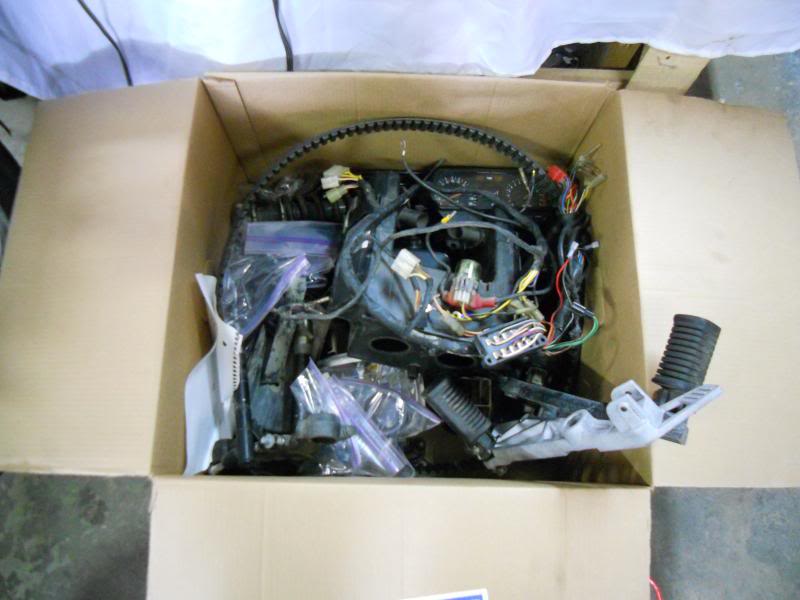

Hafrod
Beiträge: 34
BeitragVerfasst am: Do Dez 05, 2013 4:40 pm    Titel: Antworten mit Zitat
They delivered the parts bike this morning. Brand new and never ran tires. It is missing some parts but I have a spare engine if I need it. There are a few parts in better shape than mine that I will use.
