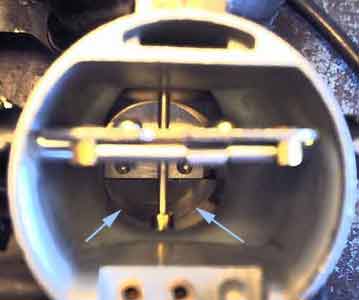

Especially look at pilot air system and at activation piloting holes for the diaphragm (one bigger and 3 micro-holes)

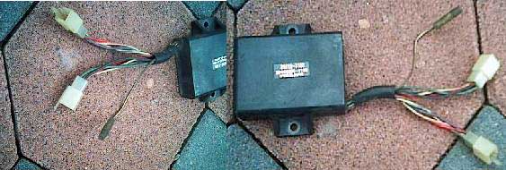

Ignition system of a gpz-305 is some "special" CDI:
not running on Battery but has direct power source.
So bike can (theoretically) run without battery (but then DC-regulator will be destruct)
CDI has own load-coil in gernerator besides the 12V coils for battery.
CDI is directly charged with 400V AC from generator ! _________________ Grüsse

Controll if needle tip is "sharp"! Sometimes some previous owner with "rustic sense" has overtigthen this filigree screw...
But If rubber seal is missing then You have secondary air which lets idle speed varigate.

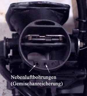

Where should butterflies be set? There a 3 little holes. Should I set it with the first hole barely visible?

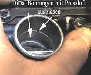

| I do not understand how to check diaframs by blowing air into the carb. Where exactly do I blow a small amount of air in? |

Hi
To make rough check of butterfly position turn to idle position and hold a lamp/torchlight behind carb ( motorside).
Look from inlet side through "closed" butterflys and You see a small ligthgap shining through edge bottom of butterflys
This should be equal on both carbs
Underpressure/moving valve(diaphragm check):
Blow softly some air into oval hole ontop of choke-side ,see Your last picture _________________ Grüsse

Look at CDI, find "extra" single cable contact and decollate contact, put CDI-Side to "ground" (frame). contact = grounded -> engine running. _________________ Grüsse
