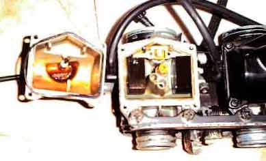

I'll try taking the bike on a longer ride today to see if it clears anything from the carbs. Fuel has some redex in it, so I hope that will help.
Already stripped the carbs down several times to clean them.
Boiled the dismantled carbs in a 10% solution of lemon juice(similar to using vinegar as it's a weak acid) last week and used carb cleaning spray afterwards.
Jets were clear, nylon fishing line pushed through the tiny holes. A few weeks back all the jets were definitely blocked with gummed fuel and rust and the bike would not run at all.
The vinegar trick looks to clean them really well as my float bowls are still lightly discoloured compared to yours.

In the first third of raising throttle only the bypass-system (idle-speed system) is runing ! And the gpz305 is also very very sensitive to carbs out of sync !
Main jet begins to start at 1/3 throttle and takes over at more than 1/2 thottle !
If the idlespeed-system is not working properly You will also encounter higher fuel-consumption and problems You describe seem typically for that.
If the carbs are awesome out of sync You will have different

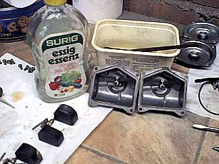

If the jets were blocked by gum best is to use vinegar. I don't no why, but this pits the gum/rust etc.
It is not the acid which does the work ! In the past I also tried lemmon-juice, but that didn't liqudate these residues bur only the rust !
Take a plastic-bowl enough to fit the carb-body, fill in water with some vinegar-essence or buy the cheapest bottle vinegar You can find. Usually it is 2-5% acid. Soak parts (jets; carb-body etc.) well for about 5 Minutes and take a toothbrush or something similar to brush it while in the plastic-bowl. If it is clean use fresh water to rinse the acid.
Done
Maybe You need an air-comrpessor to blow the jets and the very small /"microscopic" drills (like these) in the carb-body and in the jets.
The vinegar does You a favourite there: It will pit the rust *and* embrittle the gum, so it is easy to brush it or to blow it away after !
This does not work with lemon-acid: it only dissolves the rust, not the gum-rubbish.

You will be pleased to know the latest treatment of the carb cleaning fiasco has cured the running problems. The carbs will probably need setting up with vacuum gauges etc to get the maximum performance out of the rebuilt engine.
After the vinegar soak I rinsed the carbs under the tap and then put them in the dishwasher with a little washing up liquid.
Then I rinsed vinegar through all the drillings again using a pipette. scrubbed the carb body with a nylon brush and washing up liquid as the carbs looked cleaner for going in the dishwasher.
Put the carbs in the dishwasher again and when nearly dry squirted carb cleaner(from an aerosol can) into all the drillings, carbs now look almost spotless!
Lubricated all the springs and moving parts with copper lube(grease) and/or ptfe lubricant, then put them back on the bike.
The vinegar must have done the trick as my mechanic had suggested throwing the carbs away, but the bike is running better now than at any time since I bought it 15 years ago.
